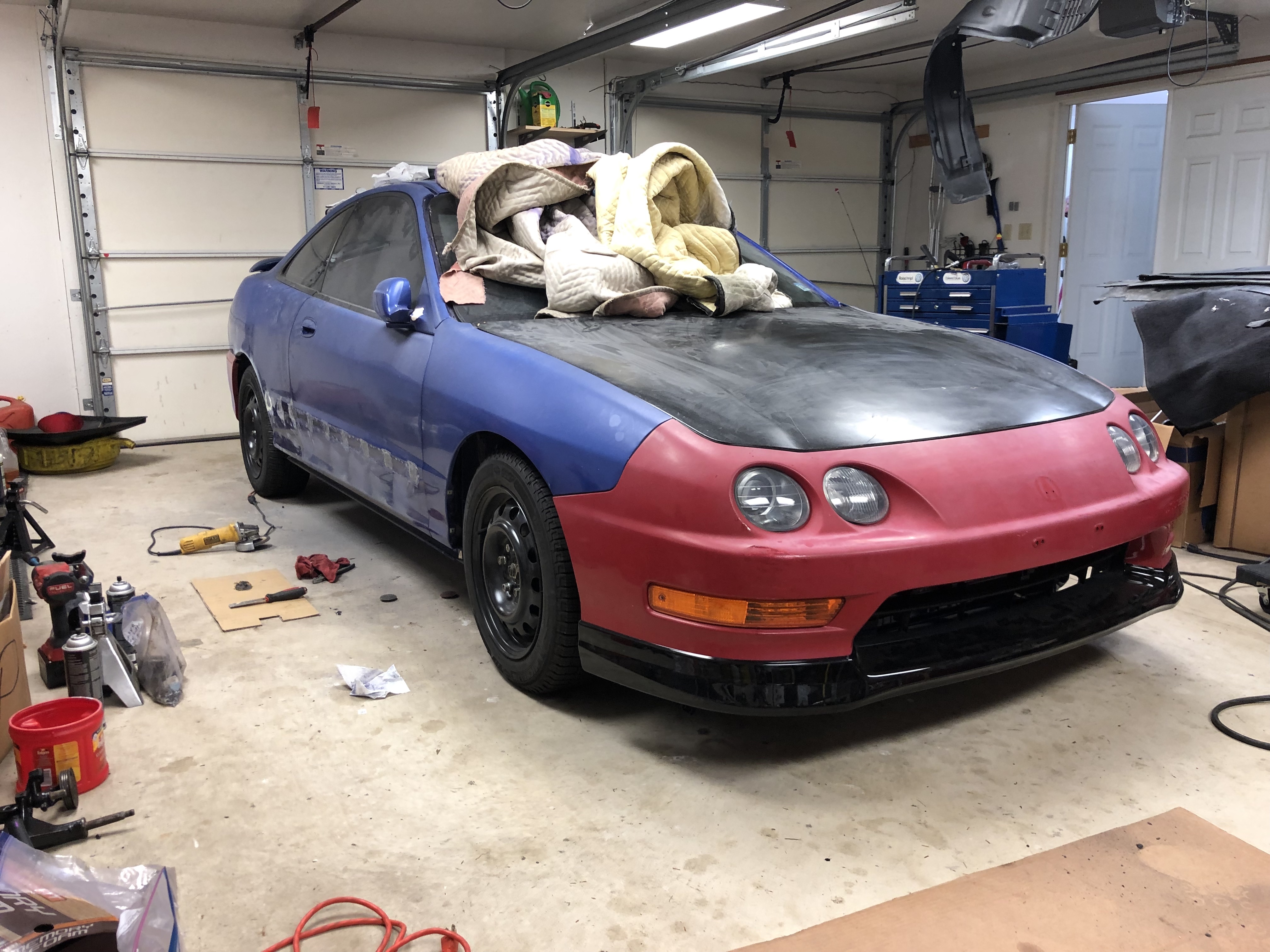

So here it is.... My 1998 Integra GSR in Super Sonic Blue Pearl. Overall its a basket case, lots of imperfections in the body. No Excessive rust though which is nice. The sun seemed to do more damage than anything.
The car is A 1998 GSR with 93k miles on It.
Pictures don't do it justice but the paint is horribly oxidized. Early on I went over the car with a paint pen and picked at what I saw wrong with the body. I wanted to know for sure if this was something I wanted to get into or just cash out and try and unload it. Both rear quarters were solid with only a little surface rust. Unfortunately, the LR quarter panel took a hit at some point and has about 1/4 inch of bondo in it, so that got to go. The RR rear took a slight hit and was creased but seemed repairable.

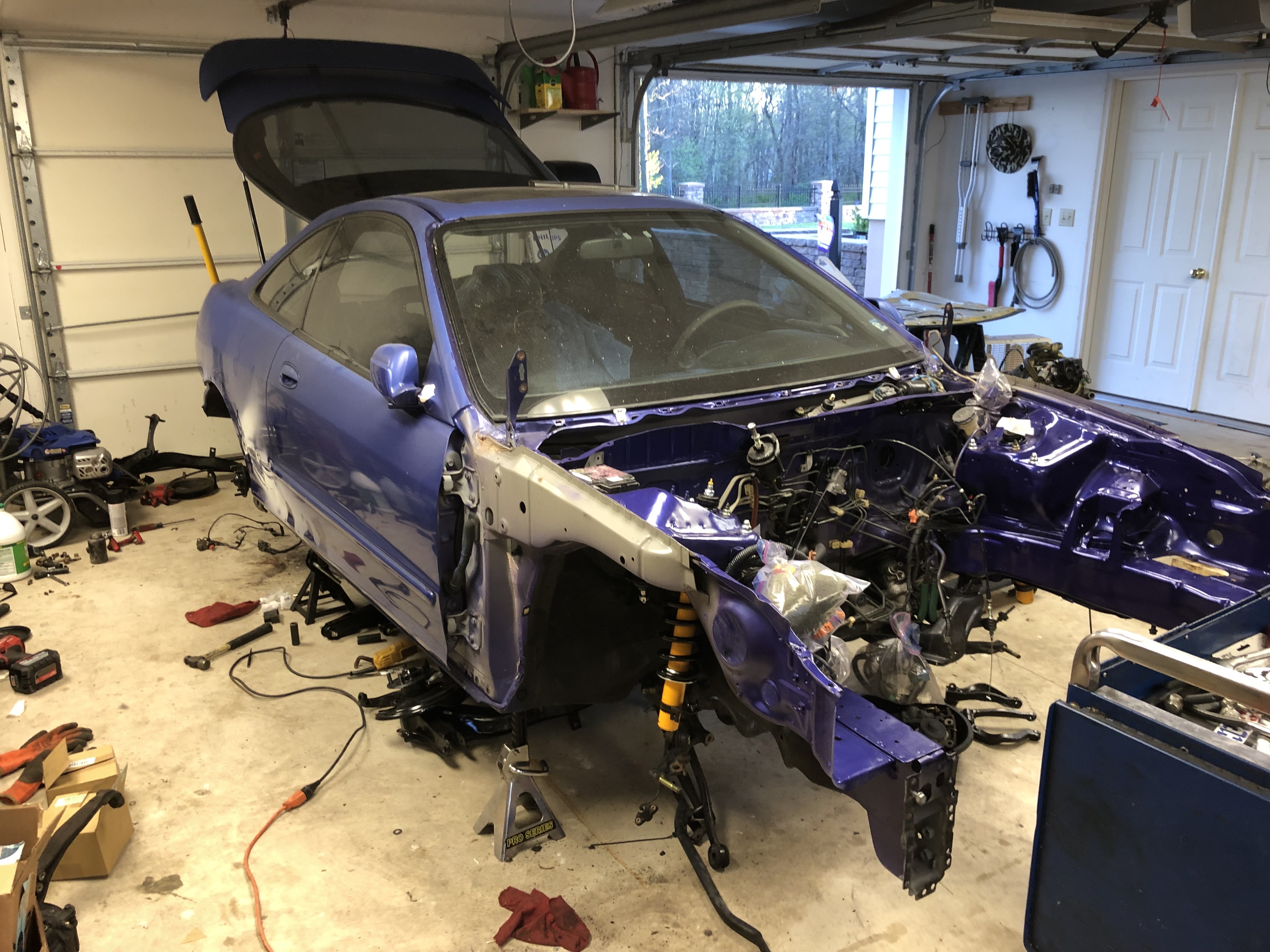

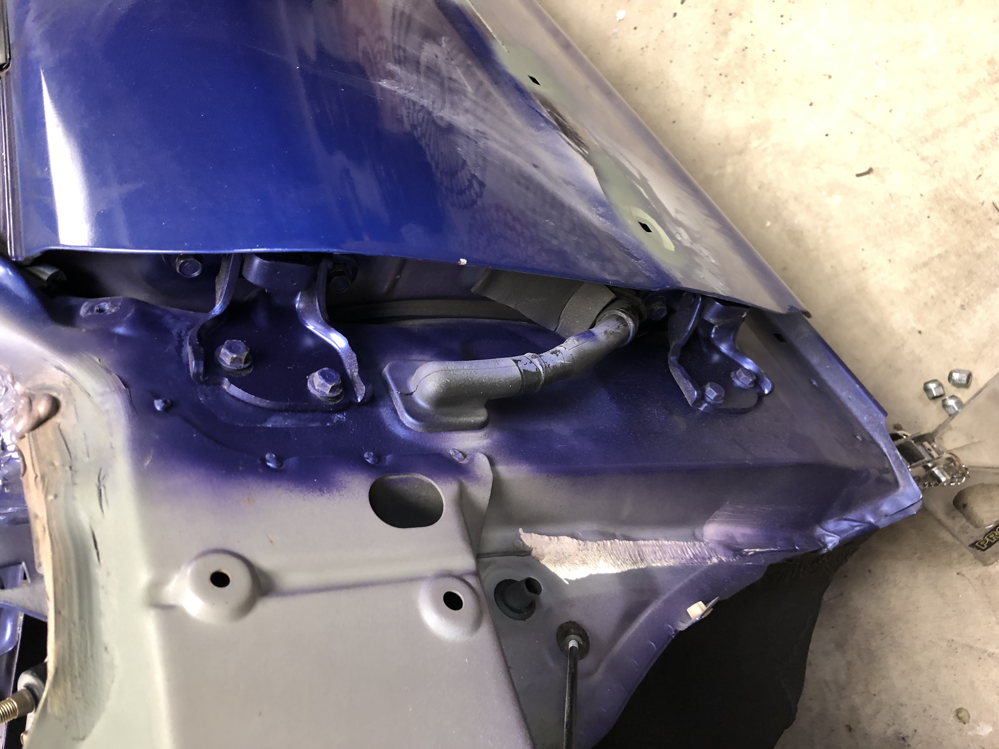

The front also took a hit and buckled the core support. At this point I accepted the challenge and really started digging in. I opted to get an OEM acura core support so I knew it would fit correctly and started looking for a doner to replace the rear
quarter panel.
The hood was another place it took a hit and cause the core support to buckle in several places.
Over the past year that I've been working on the car I tried to stay in one area start to finish. Sometimes out of boredom I'd do some work on something else but for the most part I focused on the engine bay from when the car was purchased till about August 2019. Here you can see I started on the engine bay.

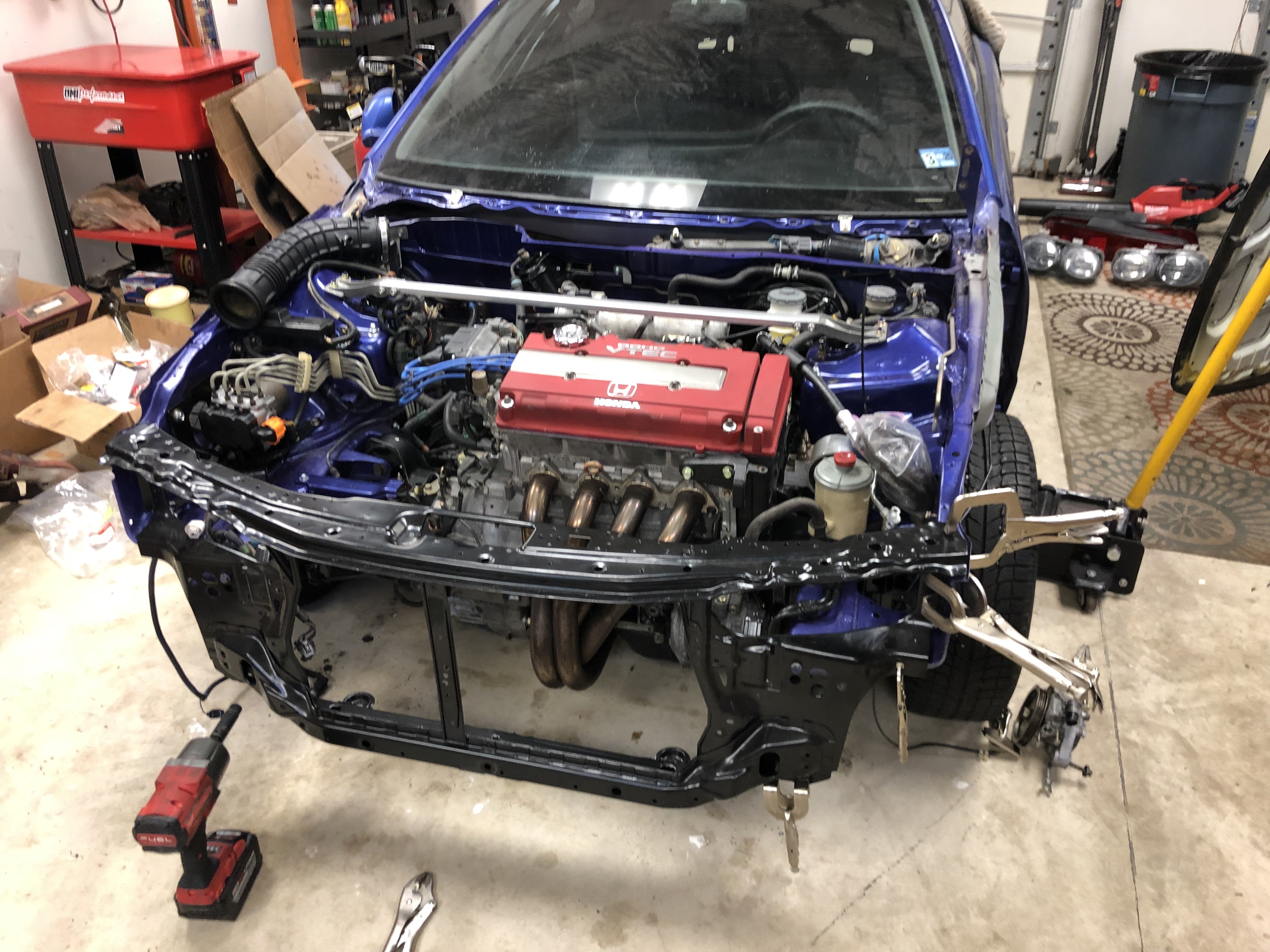

Starting to weld core support
After checking the fitment a million and one times I started welding in the core support. I borrowed an Lincoln welder from a friend. It was a 120v solid wire. For the purposes of replacing spot welds it was enough. I just recently bought a new welder because I knew I'd be getting into the welding end of things a little heavier when it comes time to work on the quarter panels. I'll elaborate on that in a later post.
Finshed engine bay
Finshed engine bay
As you can see I've already diverted from the original plan and swapped an ITR engine in place of the original GSR drivetrain. The swap is a 96-spec ITR with a Mugen 4-1 header and Spoon Sports ECM. I also picked up and new CT-Engineering air box from HeelToe. I had one on my last ITR and loved the fit and look of it. I'm very happy with the progress so far on the engine bay.

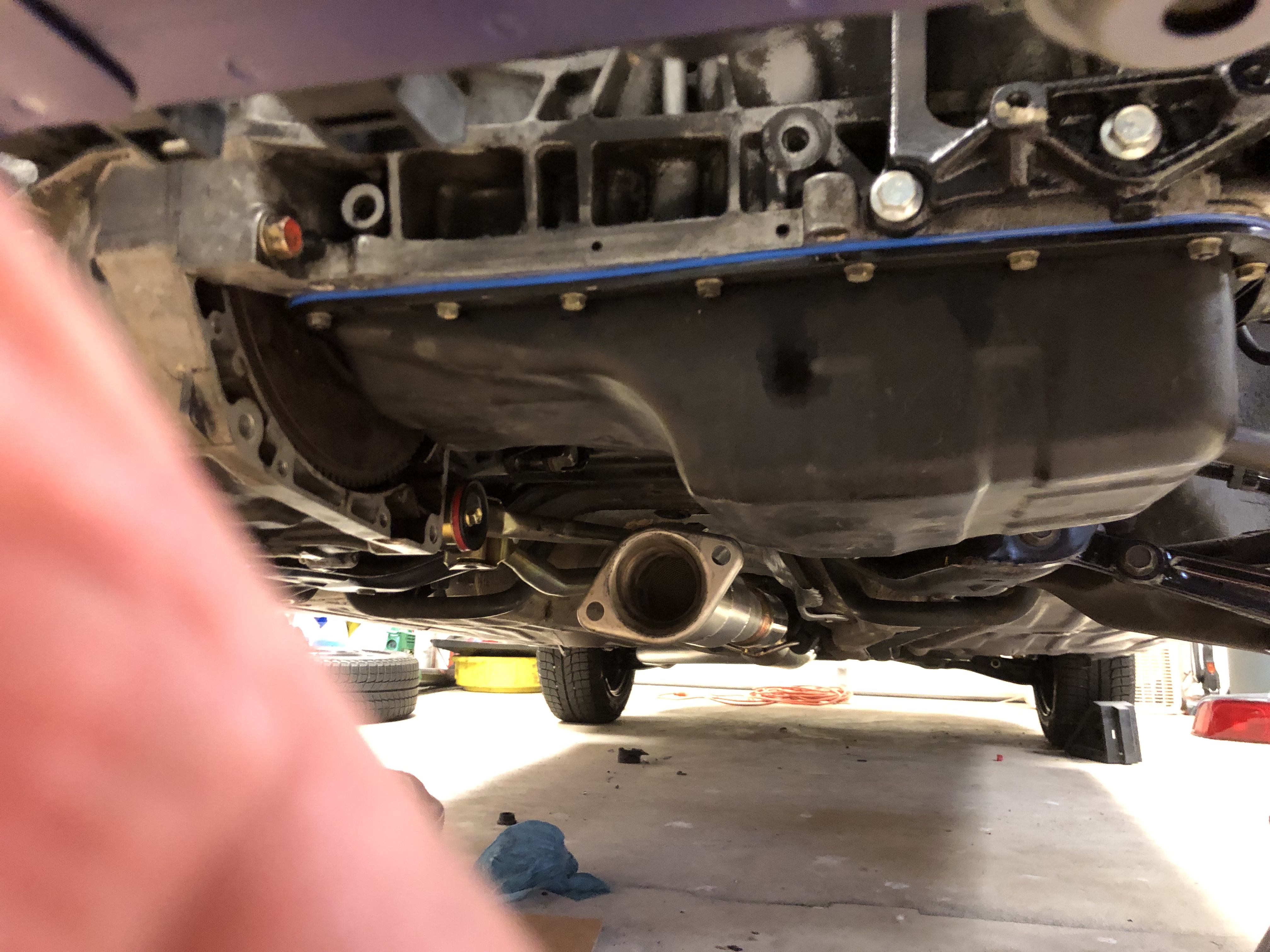

A key factor with a type R is chassis reinforcement. Starting at the front of the car the first thing most people notice is the front upper strut bar. Instead of the steel bar of the GSR the ITR has an aluminum bar. Having them side by side the ITR strut bar is slightly heavier but I would guess its less likely to flex in theory. I also noticed the first piece of sound deadening material in the cowl of the GSR which isn't in a ITR. So there's the first increase rigidity and decrease weight formula that honda would apply to the ITR. Now there is a lower bar on the subframe but that's same on both ITR and GSR and I think other models that have this front subframe.
oil pan
oil pan

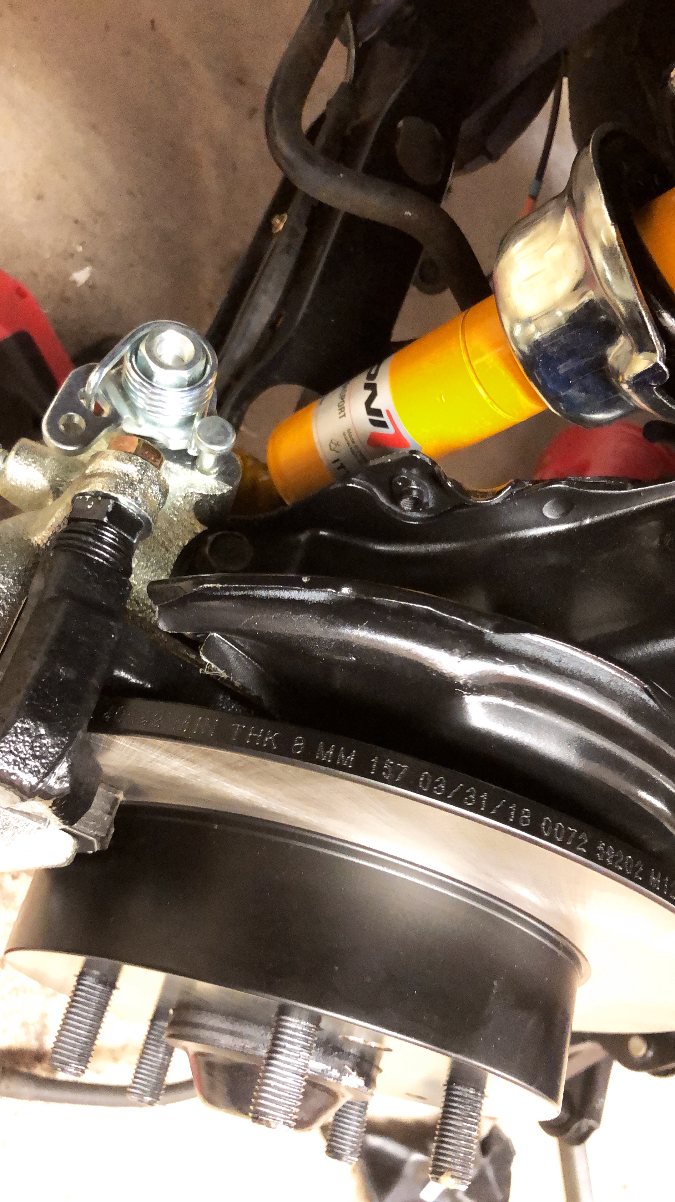

Starting with the front I replaced the wheels bearings and lower ball joints. The wheel bearings I used 98 CRV and ball joints are Integra. Gave it a coat of Rustoleum and chased all the threaded holes with taps. I reused the hubs going back together and ordered new rotor dust shields as they were mangled. I had to order the dust shields for a 98 CRV as they are also different on the 98 spec ITR due to the larger bearings.
knuckles and RLCA
knuckles and RLCA
Suspension, brakes and wheels
I replaced the front and rear calipers and brake line front and rear. The rears I could use USDM calipers and rotors no problem. The Fronts however are USDM ITR rotors and 98 CRV Brake calipers and brackets. The calipers themselves are the same between 98-spec, USDM, and EK9. The main difference is in the bracket where the 98-spec is offset 5mm different. Here I'm test fitting my 5zigen wheel in the front. Fun fact I learned when ordering my exhaust. "GO" in Japanese is pronounced like "Five" and "Zigen" means "Team". So that's how they ended up with 5 in the name. At least that's what I understood.

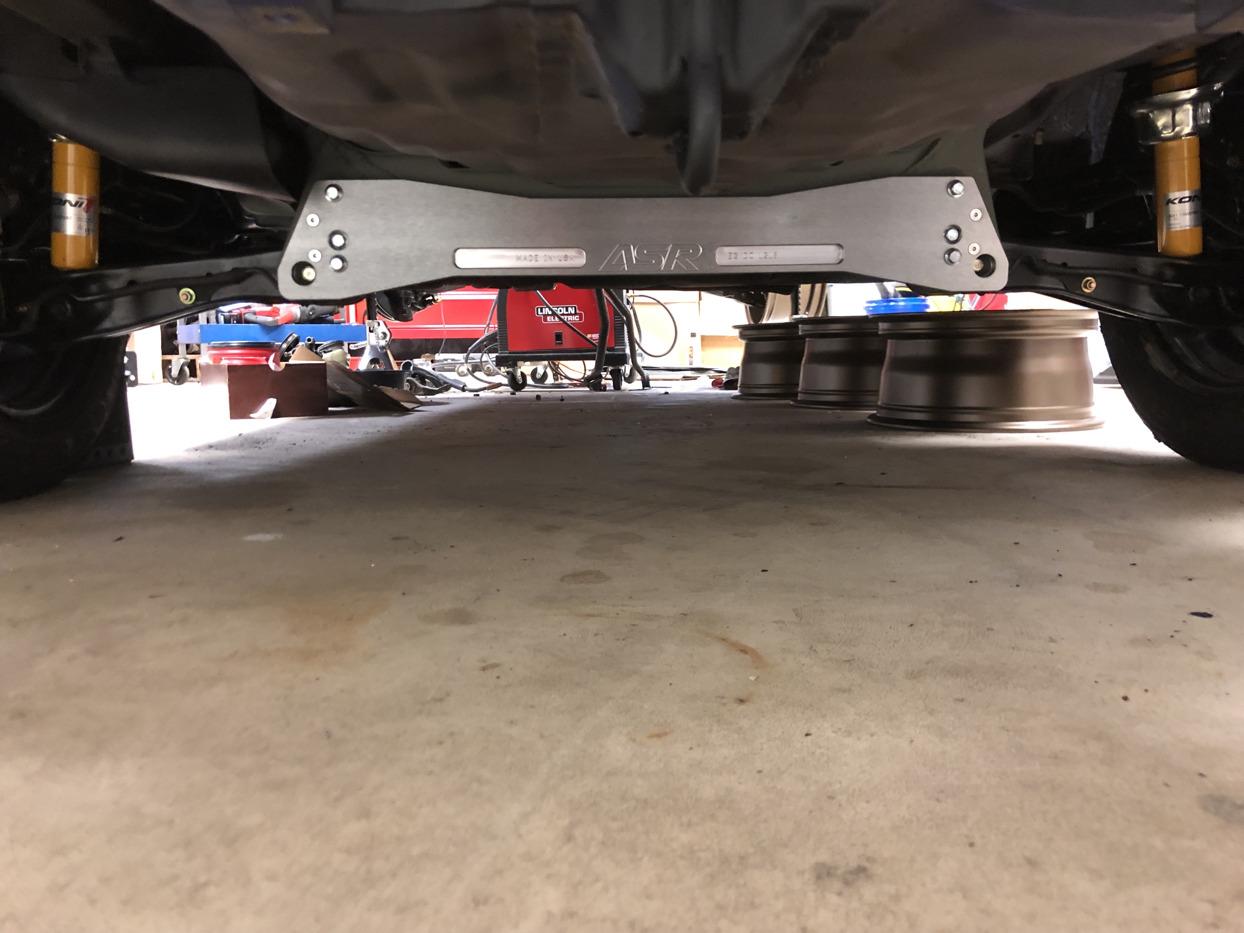

In terms of dimensions the GSR and ITR are very similar chassis wise. Looking at my frame measurements in the repair manual every mounting point for the suspension is in the same location. I used 98 spec upper control arms and ITR RLCA. Again replacing all the bushings, wire wheeling and painting them up. New hardware was used and in the process I accidently ordered bolts for and ITR and when I went to put in the control arms I had a lot of bolt left over due to the smaller rear subframe on the GSR. I cleaned some surface rust off the subframe and gave it a coat of primer and under coating. After that I installed an ASR subframe brace. Wanting to keep ABS I went about routing the GSR sensors through all that mess. It was actually quite easy. Being that the RLCA were off of a non-abs car I had to drill 2 holes in each side to mount the harness and just ran a bolt and locking nut. The harness fit perfect under the ASR bar. You can see were the harness would have gone between the shock fork and GSR LCA, it routed perfectly over top of the bolt on the ITR LCA. I used ITR fitment Koni Yellows and stock ITR springs, the fronts being on the lower perch.
subframe
subframe

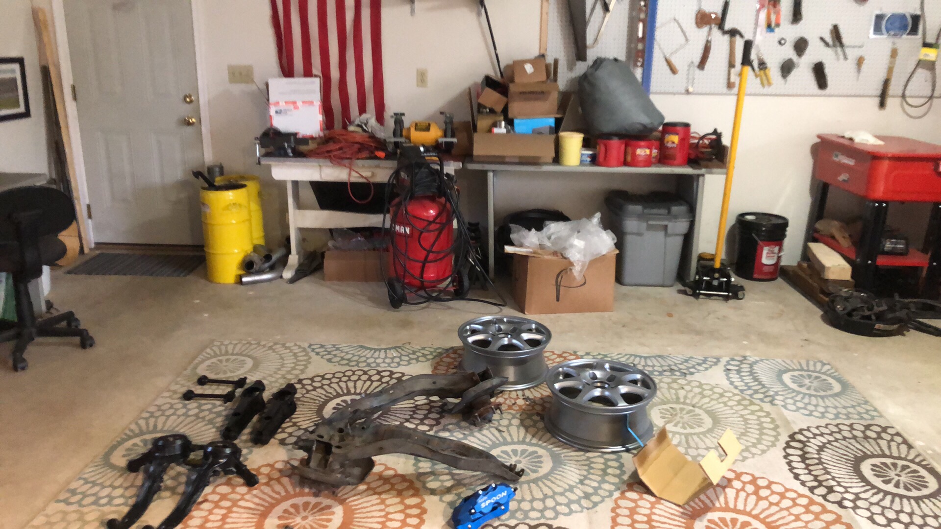

Getting rear calipers for an ITR was a bit of a wait. Rock Auto had one rebuilt set. That may be and issue for future ITR restorations, though rebuilding them yourself can always be an option.
